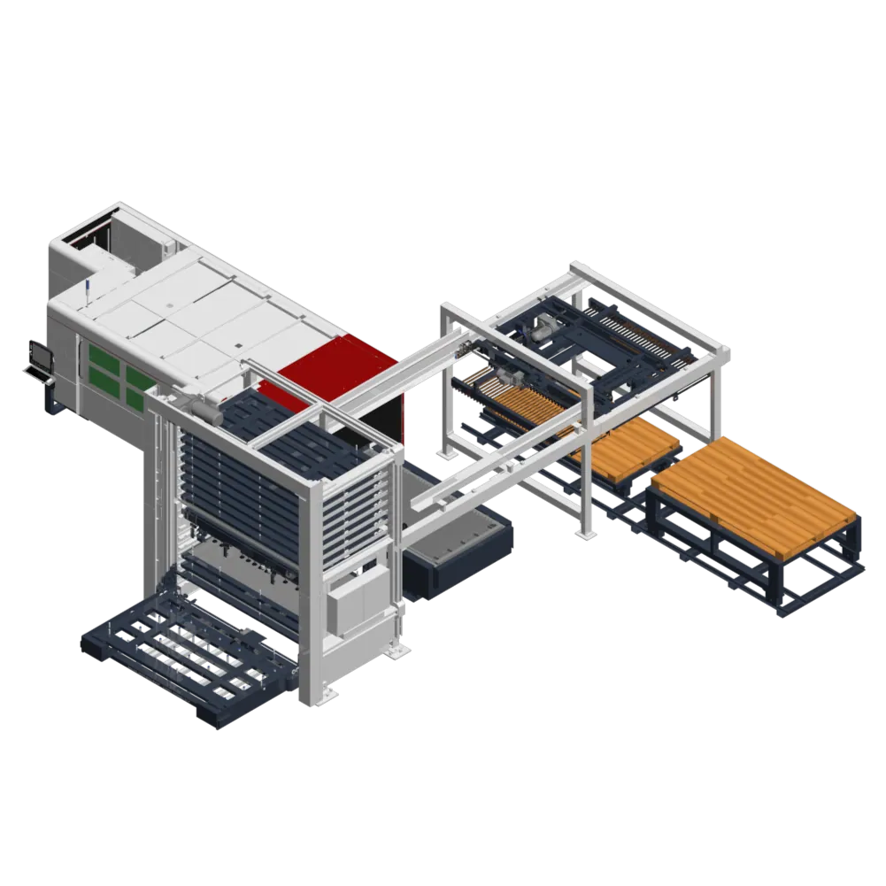

A configurable, expandable sheet loader with a load/unload cycle as little as 52 seconds.

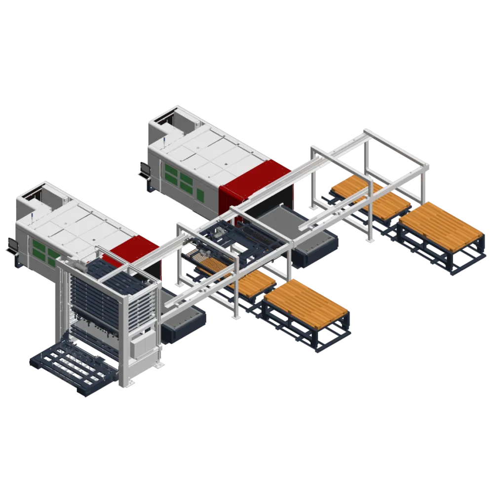

With intelligent, fully independent load and unload units that can easily support up to four lasers on the same line, and with dual-automated SmartStation carts for both load and unload—each capable of supporting 11,000 lbs. of raw material or finished goods—the SmartFlex RAPID is as powerful and versatile as it is fast.
Our RAPID Tower maintains all of the advanced features and speed of our RAPID Base with the added ability to store an incredible amount of raw material with a standard 8 shelves. It can be configured with as many as 46 shelves with multiple towers and can be serviced by up to 3 lasers on a single line.
