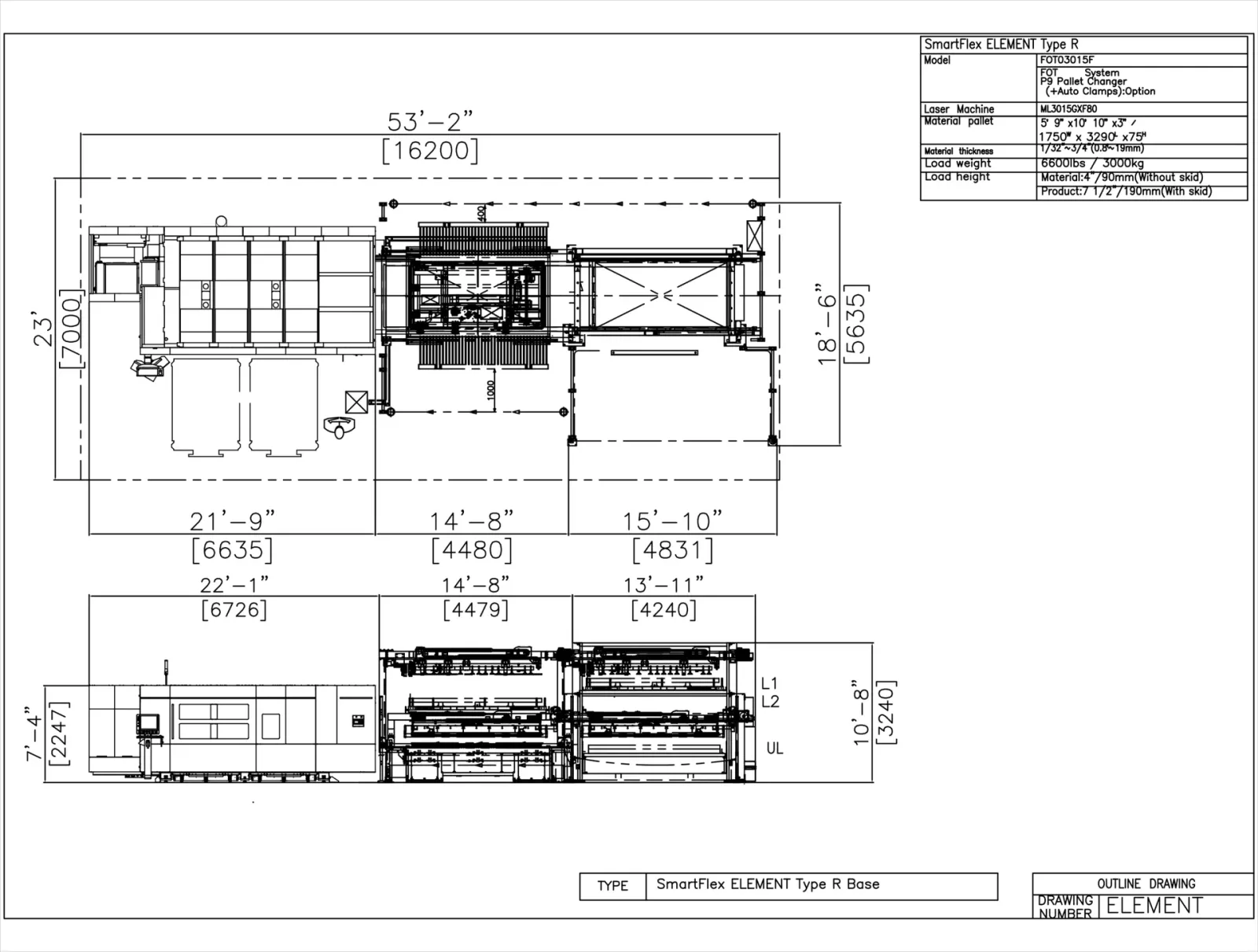

SmartFlex ELEMENT configurations
ELEMENT Type-R Base
An updated and improved version of one of our best-selling automation systems, now expandable. Comes standard with two raw-material shelves and a floor-located finished-goods area.
- 2 raw-material shelves
- ¾″ sheet capacity
- Expandable

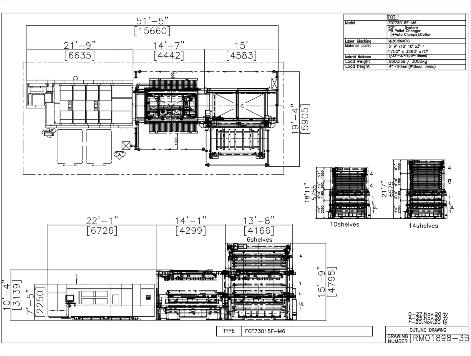

ELEMENT Warehouse Type-R
Adds a storage tower to the Type-R for even more flexibility. The space-saving footprint remains virtually unchanged, and the tower can be retrofitted to any ELEMENT Type-R at any time.
- 6 to 14 raw-material shelves
- Retrofits to any Type-R
