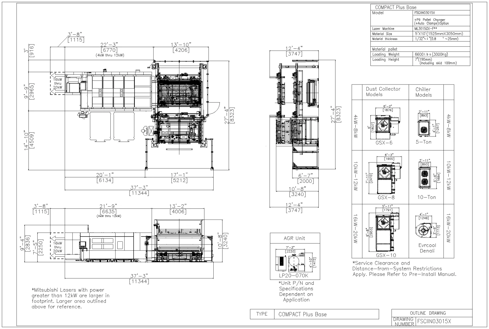

COMPACT Plus Base
The full-featured, expandable system that anchors our COMPACT line of automation, in 3015 and 4020. A powerful and reliable system that will grow with you.
- Under 38′ x 28′ (3015)
- 75-second load
- Expandable

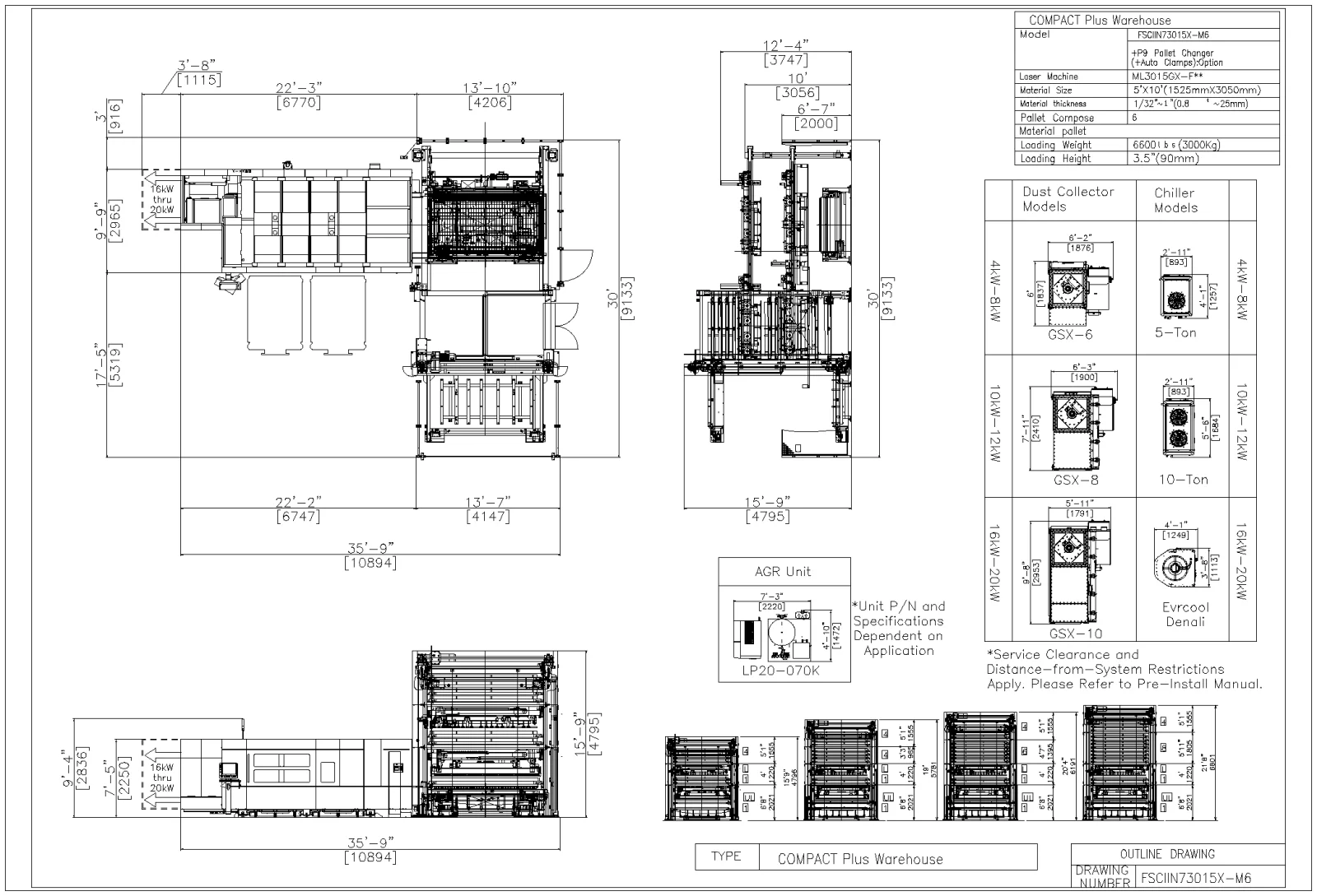

COMPACT Plus Warehouse
All of the benefits of the COMPACT with dramatically enhanced storage: it holds both raw material and finished goods for many hours of lights-out production.
- About 36′ x 30′ (3015)
- 6 to 34 shelves (3015)
- 6 to 30 shelves (4020)
